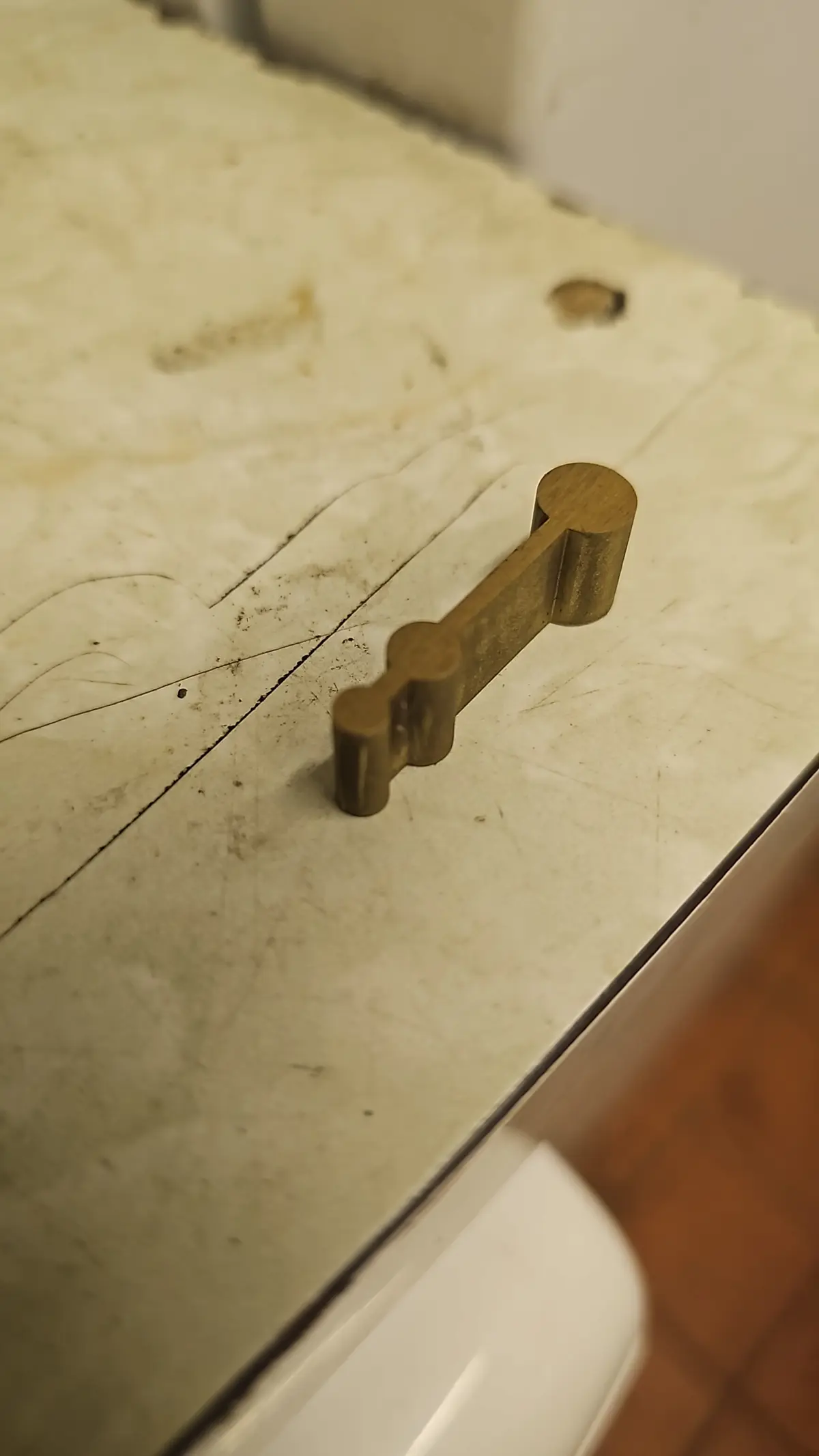

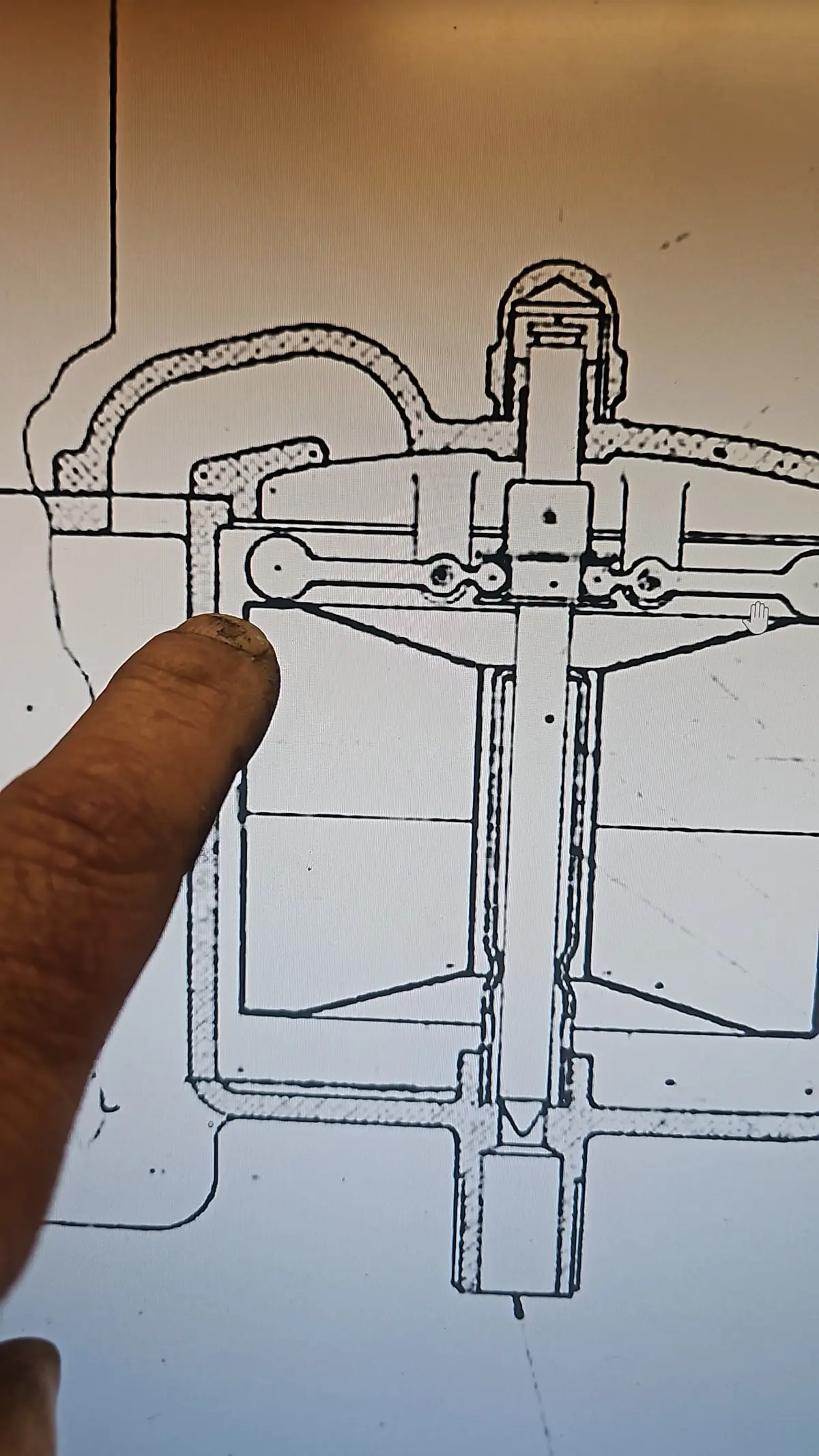

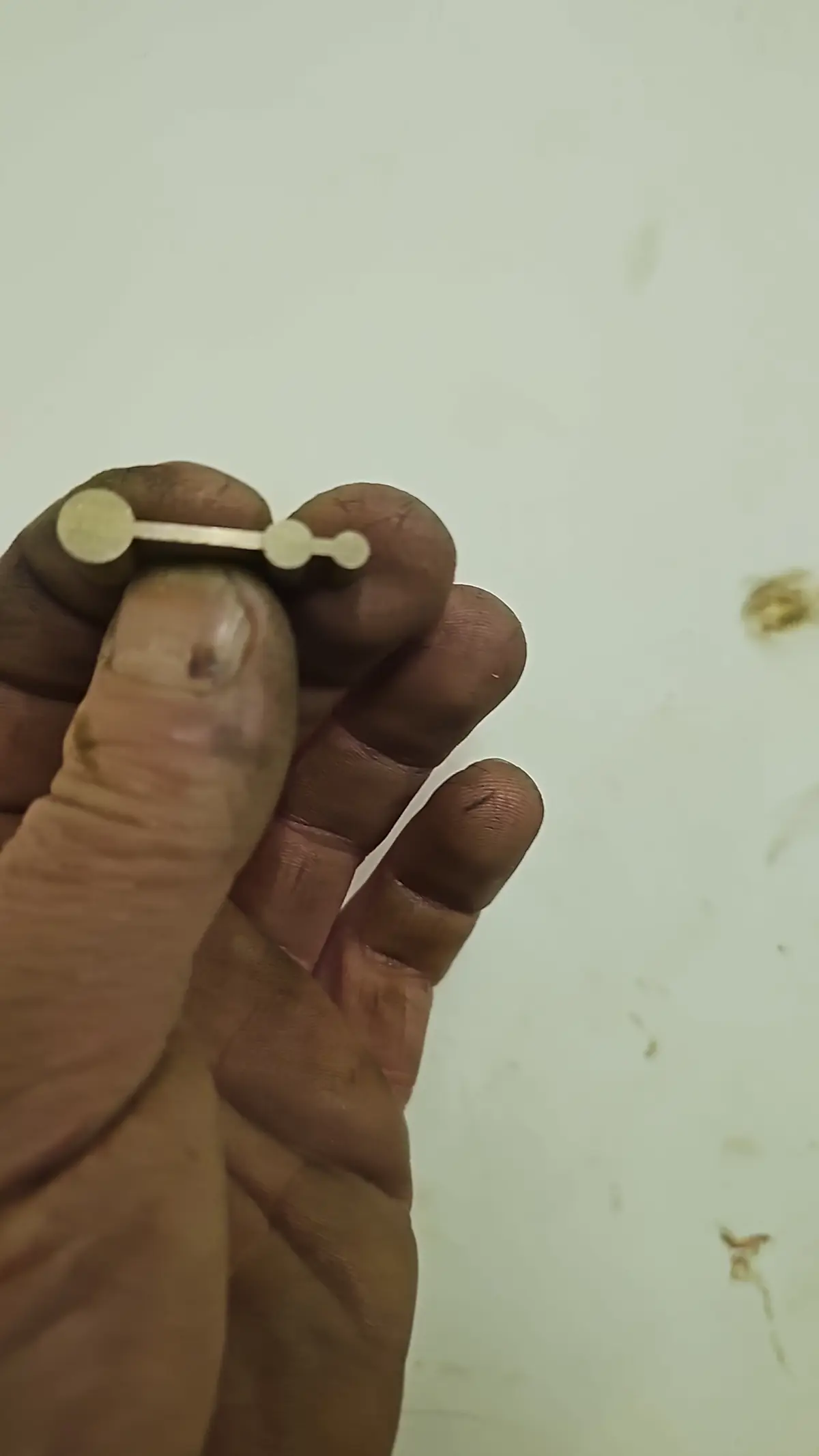

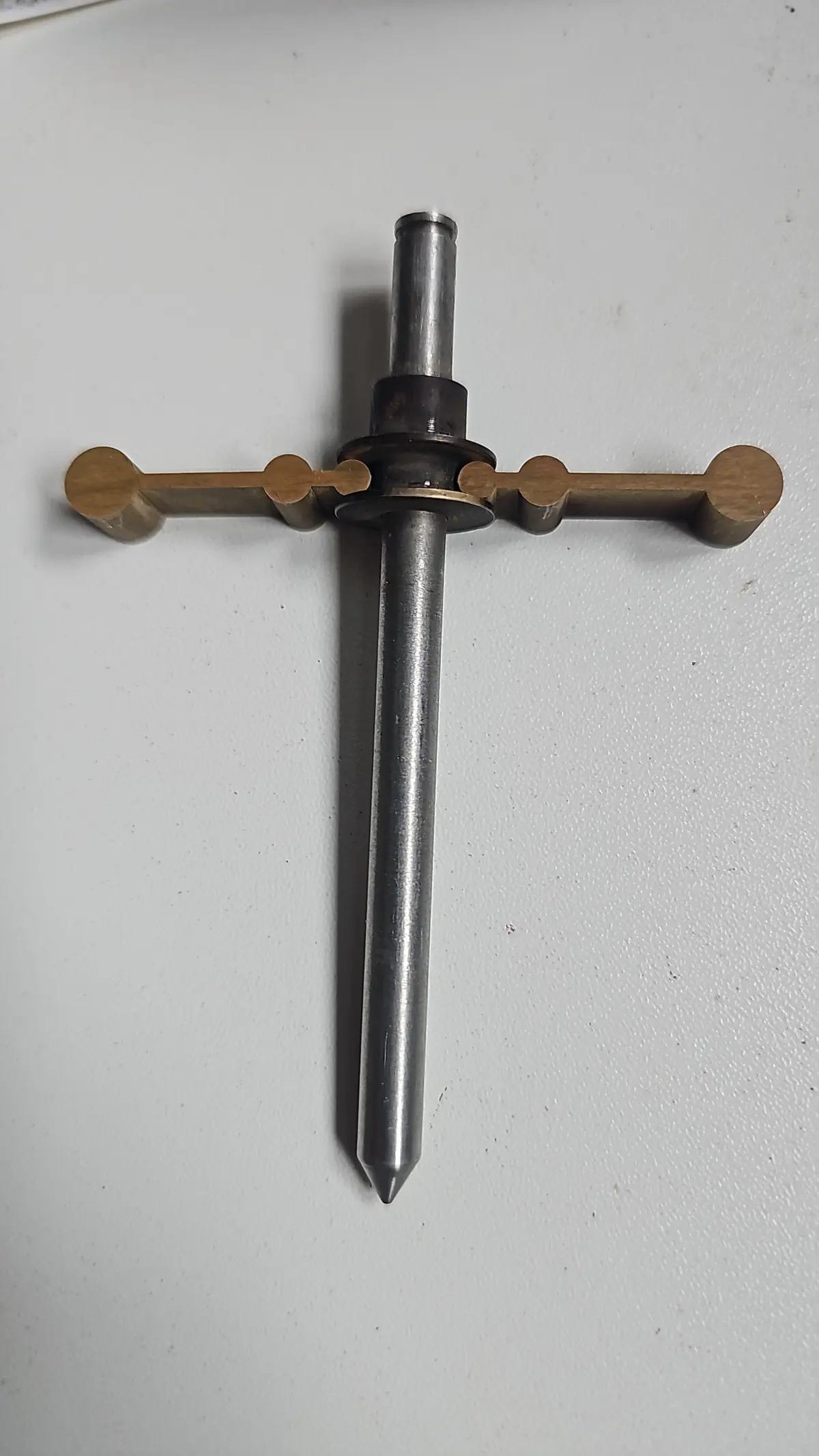

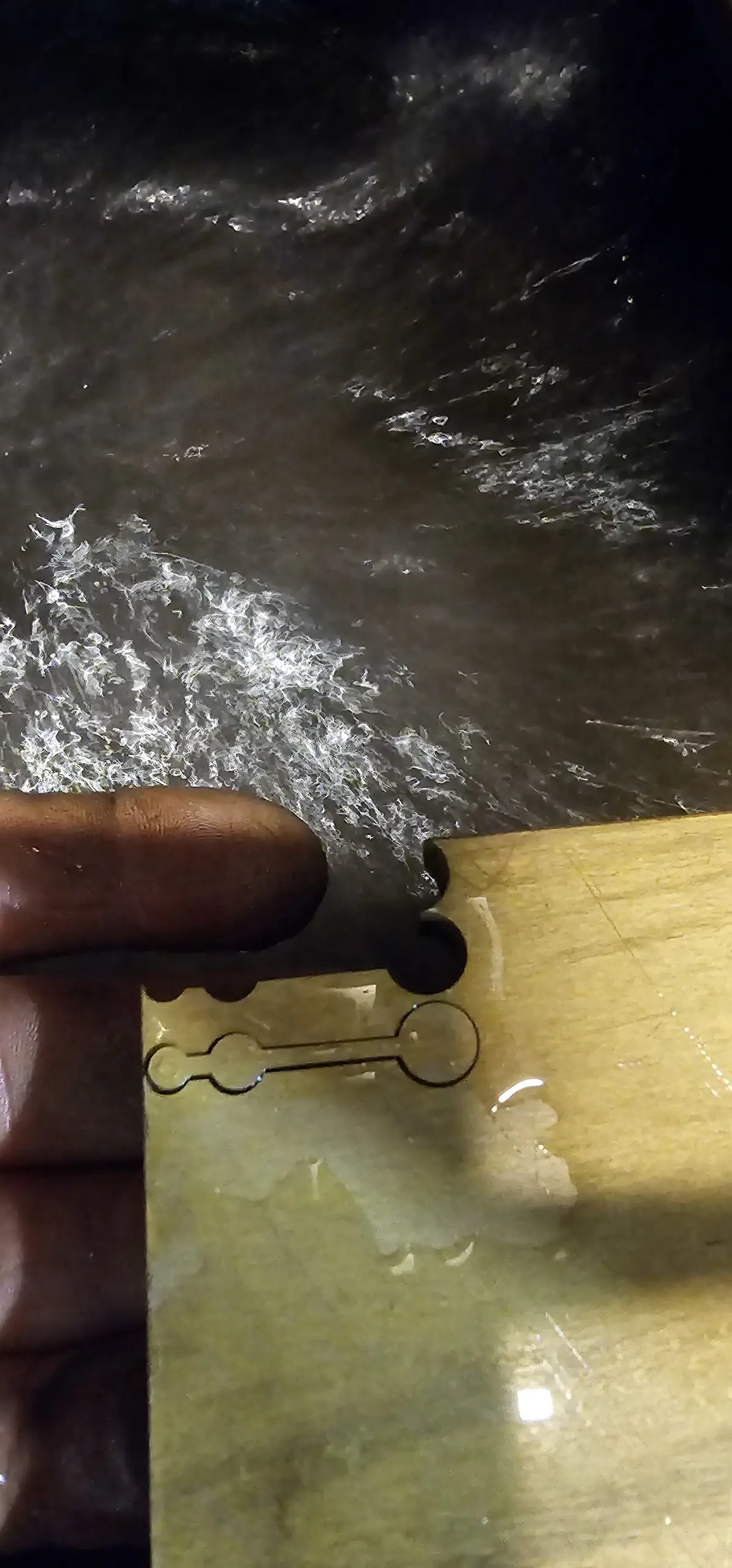

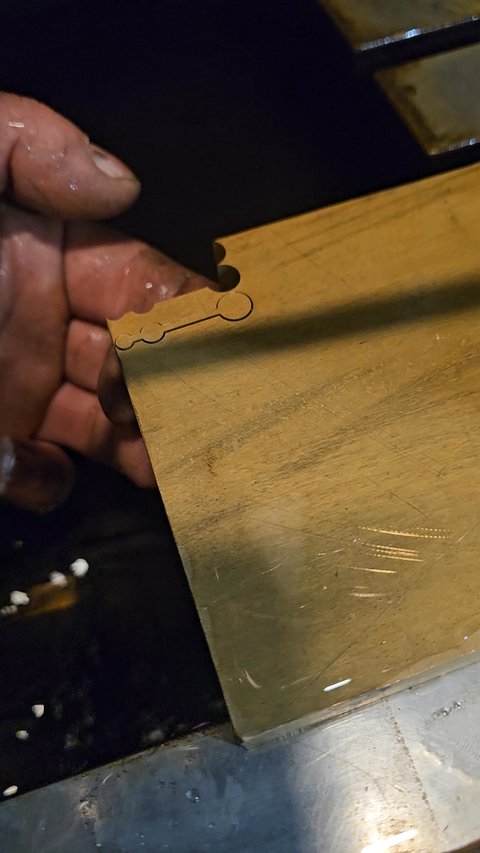

The float has these two hinged weights that sit on its edge as the level drops - the opposite end rises and lifts the needle from its seat and the level is maintained. These parts are cut using an electrical discharge machine EDM or wire eroder (video shows the cut).
