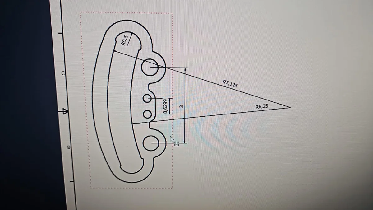

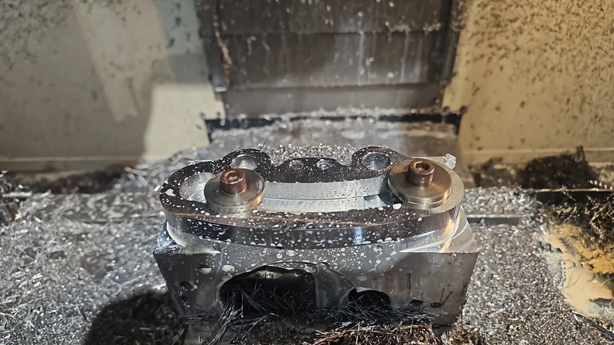

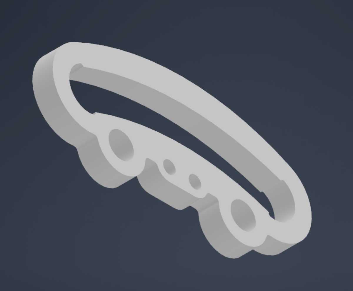

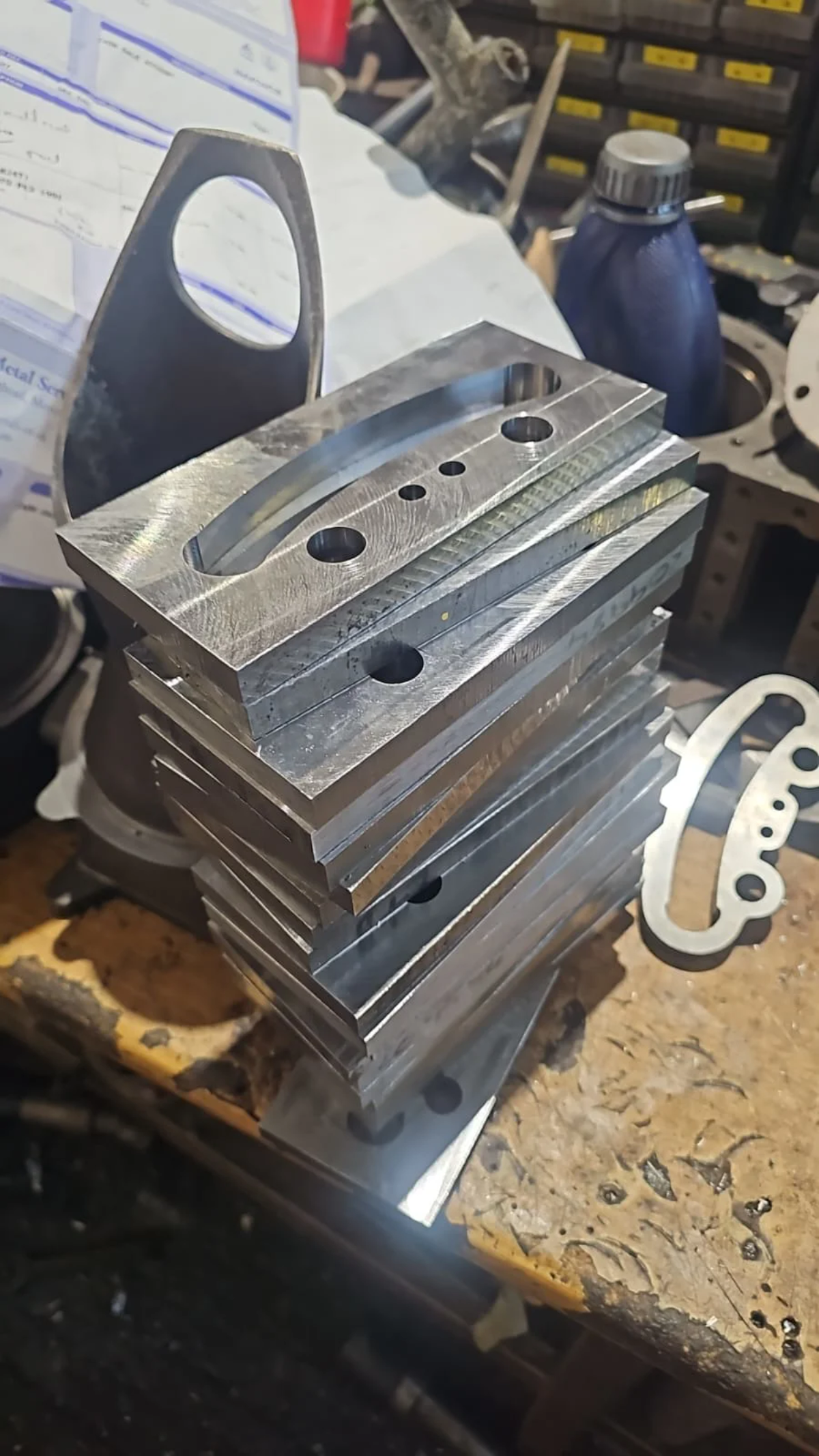

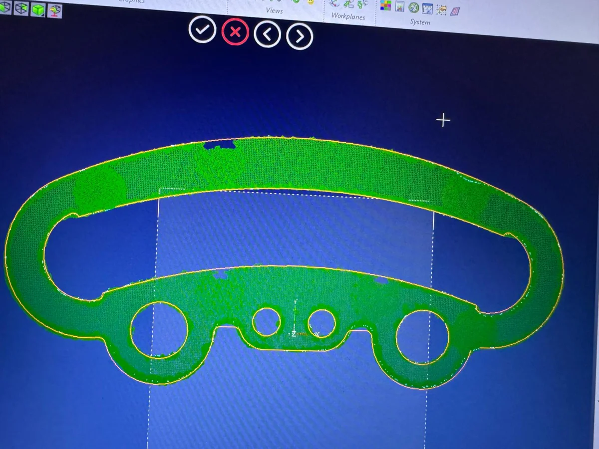

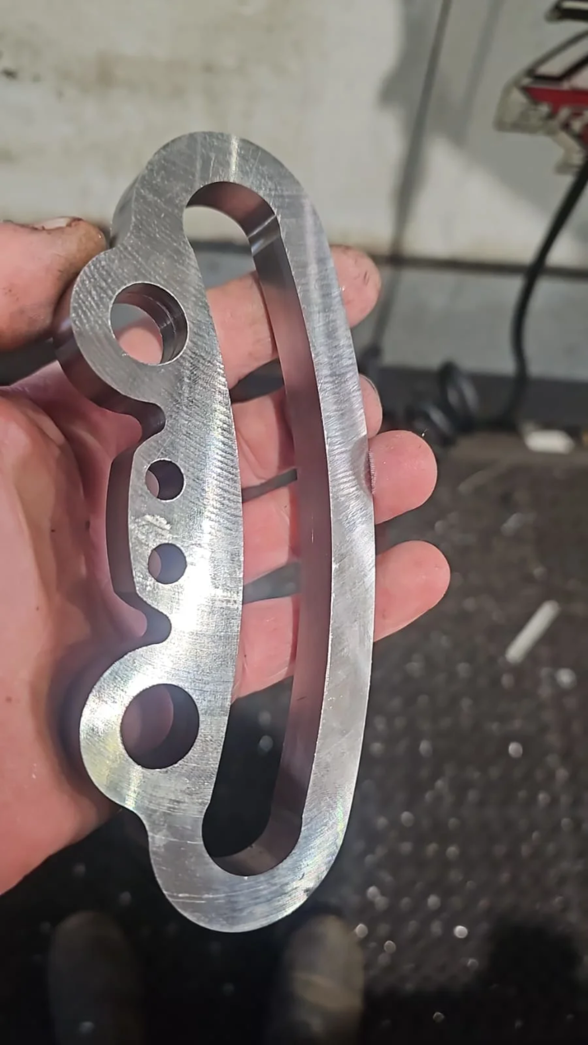

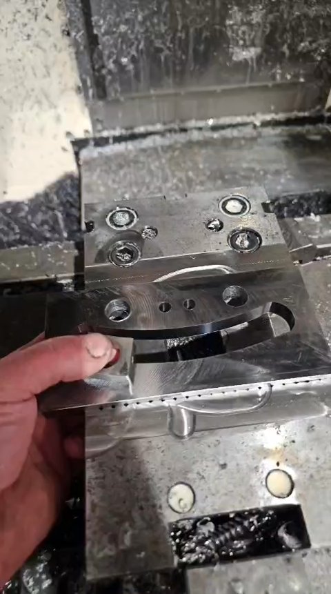

We discovered that the expansion links were worn in one engine and broken in F30 so decided that all the engines were probably in a similar condition and set about making these parts. these parts are now ready for heat treatment and then grinding
