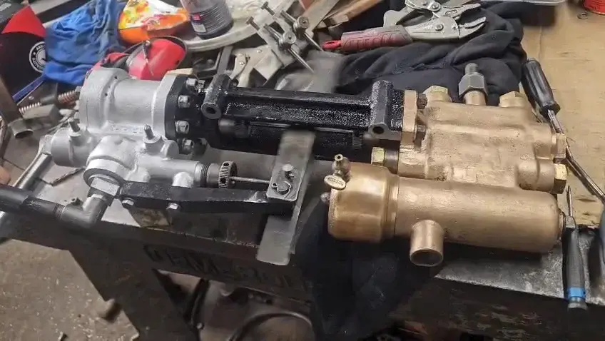

@chris I assume this is run on residue steam from the engine heading to the condenser?
no, this is run on full generator pressure and temperature, no expansion of the steam and exhaust at full pressure and temperature !!!!!!!!!!!! when I first started my Doble journey I visited Norman Shanklin and F34 and was perplexed by zig zag of piping under the running boards, it turns out that this was the exhaust line from the pump and they were trying to loose heat before dumping the exhaust into the condenser, the idea of an independent pump was correct but this was a very in efficient answer to the problem
Chris, was there not enough excess steam to run it on the engine return?
that would defeat the object of it running independent to the car moving, however..... a little later in NZ (1931) A & G Price were working on the same issues and designed a vee twin auxiliary unit that did all the functions that the model E auxiliary unit did and was, as you say driven from the exhaust back pressure, and to address the issue of being independent to the vehicle moving there was a steam blead via a diaphragm that added steam if the exhaust pressure dropped
That make sense to me. I guess the other way to do it is run it off an electric motor. Did anybody try that?
everybody tried that, F30 had and electric scavenge pump from the condenser back to the water tank, an electric water pump an electric fuel pump, every corner of the water tank had been cut out to allow the room for more and more pumps and shafts, mostly because there was no auxiliary unit, which performed most tasks, see my earlier video post filmed under F30. the main issue with electric is that when the car is making steam or stationary it is not generating any power, unlike an IC car when the engine is idling the battery is still getting a charge the demand on the battery can get too much
the second video on" F30 Auxiliary's" on this forum shows under F30
